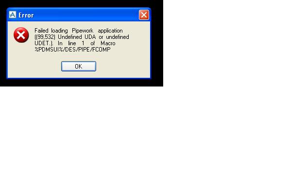

  • To resolve problem read this error message. May be that you will get idea to go through and search where is used UDa, which isn´t at your actual project ...
  • [quote=hrjogani;77858]dear all
    i have use this macro
    but i cant open pipe work menu ------> from design
    also attached snap here ,
    [attach=config]6613[/attach]
    how can resolve problem ?
    Thnx in advance
    is there any error in command line ?
    If yes plz paste it here
