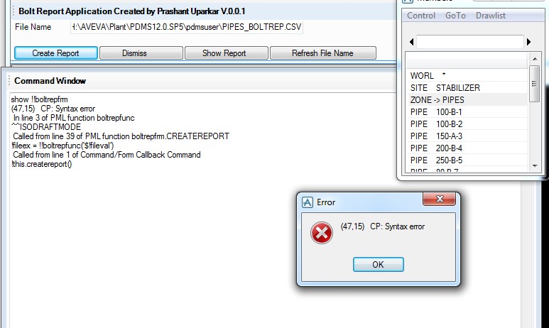

    Click on the created report staying on the zone to get the pipe wise  bolt report.
    How can I edit the macro to add a UDA column.
    thanks in advance.

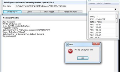

    I thank Mr. randolf 72 bolts for me to file test save this file to run, but unfortunately not possible in 11.6 Please Help meŘź
  • Raymond Metselaar
    Raymond Metselaar over 13 years ago
    I have run the file in PDMS12.1.1 and it is working.
