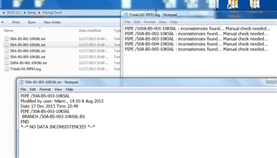

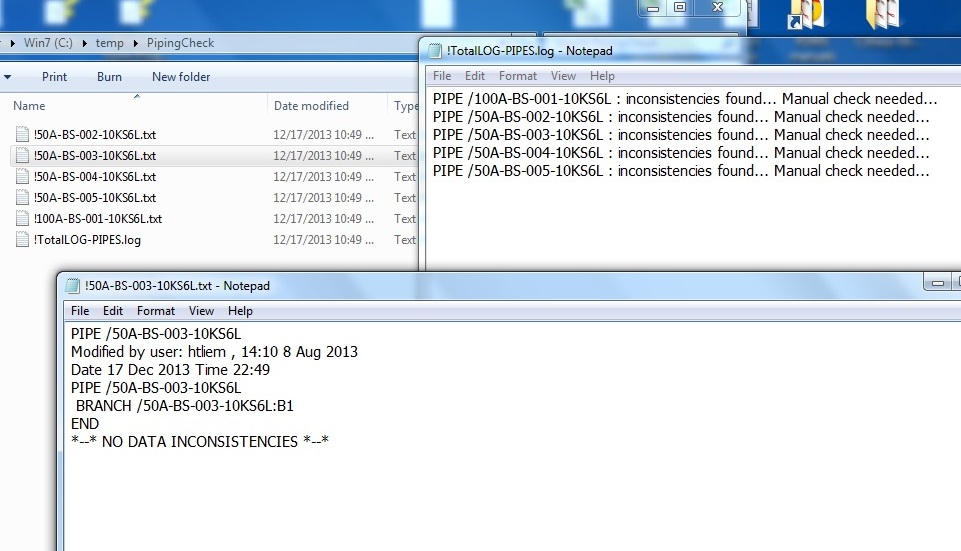

OK. I found bug
The string should look like
if (!logfileRead.FindFirst('*-* NO DATA INCONSISTENCIES *-*').String() EQ '') then
please check in
And new doc version

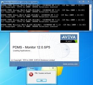

Hi RUAV,
Great piece of work and thank you for sharing the same.
There is no pmlTransFile.pmlfnc in 12.0.SP5. You should use at least 12.1 version to make it work.
Or remove from the code everything regards this function
