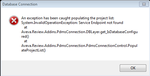

Connecting Project Database in PDMS Review 12

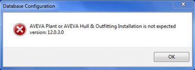

Good day. I already know what was the problem. Our AVEVA Review version is 12.1.1 but E3D needs
Aveva Review 12.2.
