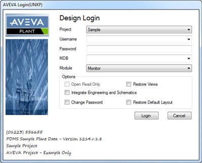

New Innonation for PDMS Login of AVEVA
  • Can you show me the name of login form?
    Thanks,
  • the location file is C:\AVEVA\Plant\PDMS12.0.SP6\PMLLIB\monitor\forms\
    Thanks you!
