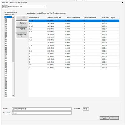

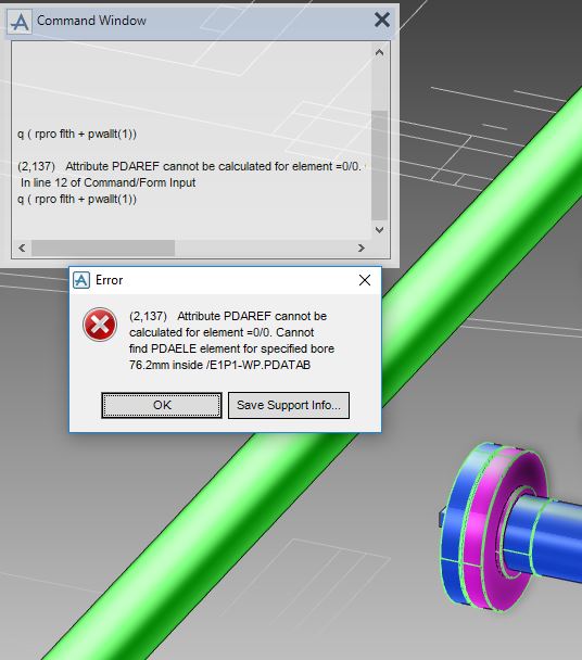

It is correct Corrado.
I changed my nominal bore to 80mm and BLEN was calculate correct.
The problem in my Catalogue is nomimal bore don't equal with [COLOR=#333333]PDATAB.
Very thanks for help!!!
