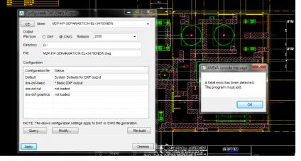

Draft Module DXF Output error

DXF Output error
rahul mali
rahul mali over 11 years ago

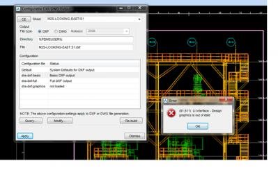

    Corrado Galluzzi over 11 years ago
    You need to update your drawing...something in the 3D model has changed...
  • rahul mali
    Try checking if there is any warning/error message in the PDMS Console Window...
  • rahul mali
    Thankyou sir
    Warning : Could not find Configuration data-set : dra-dxf-basic, Aborting!
    Have you checked you have a file called dra-dxf-basic.pmldat in your PDMS default directory (i.e. C:\AVEVA\Plant\Data12.1.SP4\pdmsui\DFLTS )?
  • rahul mali
  • rahul mali
  • rahul mali
  • rahul mali
    Yaa. I have checked .. those files are there in the dflt folder.
  • rahul mali
    All 3 pmldat files (dra-dxf-basic, dra-dxf-full and dra dxf-graphics) are inside pdmsui (defaults) folder. Even macros (default_dxf.mac) is in correct path under pdmsexe. Evars file is also correctly set.
    Still it shows this problem. I dont know what is missing?
