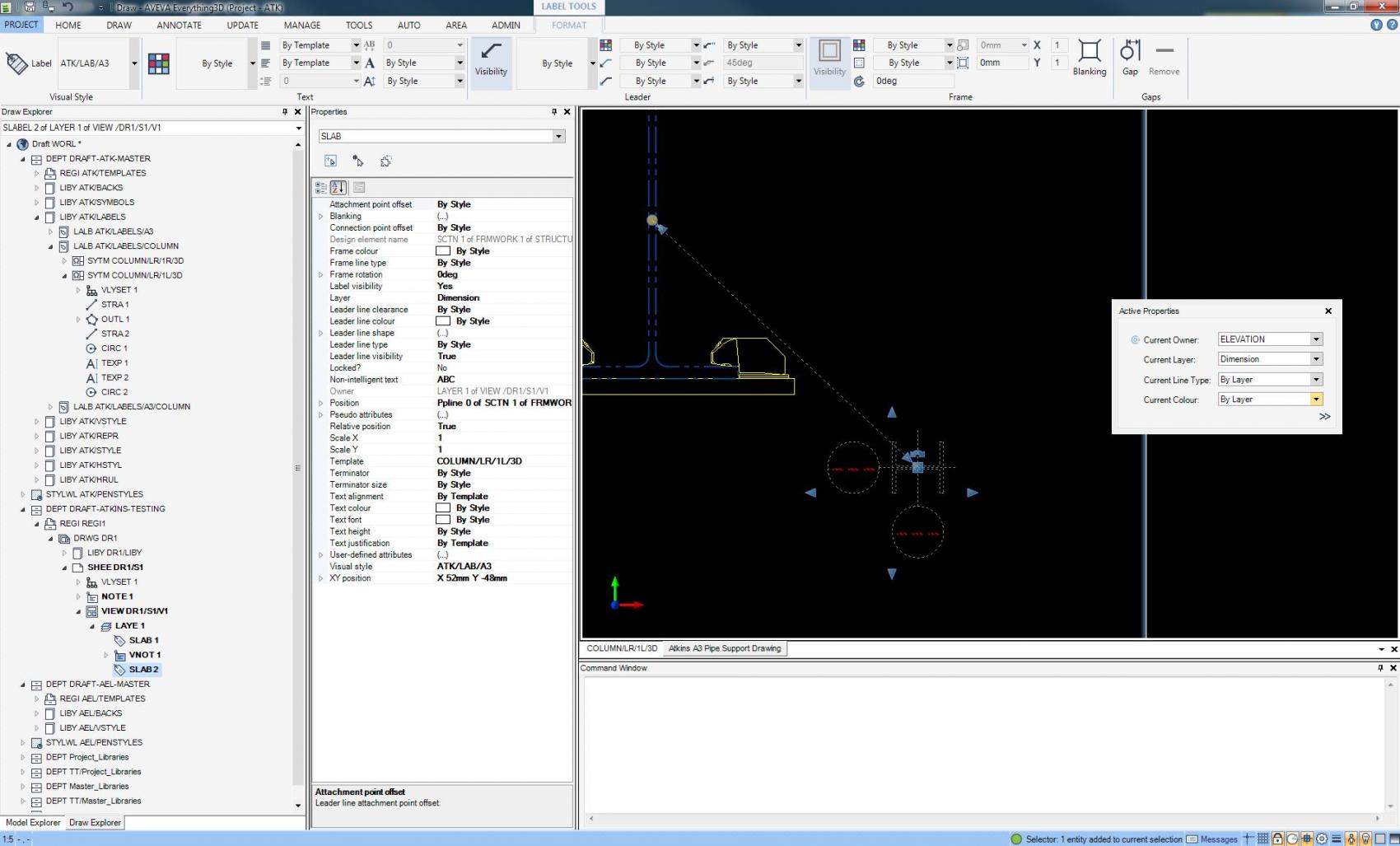

I have created a label visual style and set it as the current style.
In the style there are options to set what colour the frame etc
So when you insert a SLAB, if the vstyle has pretty much everything set to "By Template" should this mean that the SLAB should appear exactly the same as how I have created it in the SYTM?
I tried experimenting further and it seems like if you don't use the visual layers facility in the SYTM, in the drawing the colour and linetype are retained.
is this a bug?
