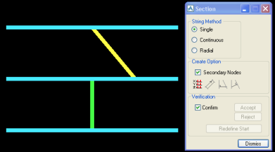

  • Oistein Hanssen
    Oistein Hanssen over 13 years ago
  • Cody Austin
    Cody Austin over 13 years ago
    It's working like it should.  When selecting your second pick, use element snap instead of midpoint and it should snap to the snod that is in the middle of the middle section.
  • Oistein Hanssen
