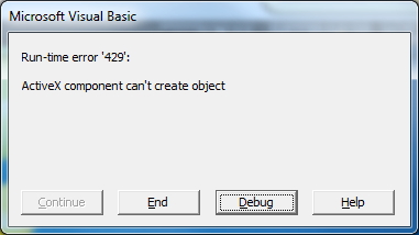

  • juan colmenares
    juan colmenares over 12 years ago
    H ....i have try it this tool, and it wsa working very well until the change of the windows plataform. Previously i have insalled windows XP, but now with windows 7 is not working....you know if is there a solution for this problem or an update of this tool...????
    Rgards.
  • Juan Manuel Gutierrez Valderrama
    Juan Manuel Gutierrez Valderrama over 12 years ago
    [QUOTE=JCS-PDMS;77257]H ....i have try it this tool, and it wsa working very well until the change of the windows plataform. Previously i have insalled windows XP, but now with windows 7 is not working....you know if is there a solution for this problem or an update of this tool...????
    Rgards.
    Con las nuevas versiones de Autocad no viene incluido il Visual basic. Pero te dice donde lo puedes descargar. ¿Cual es el error que te da?

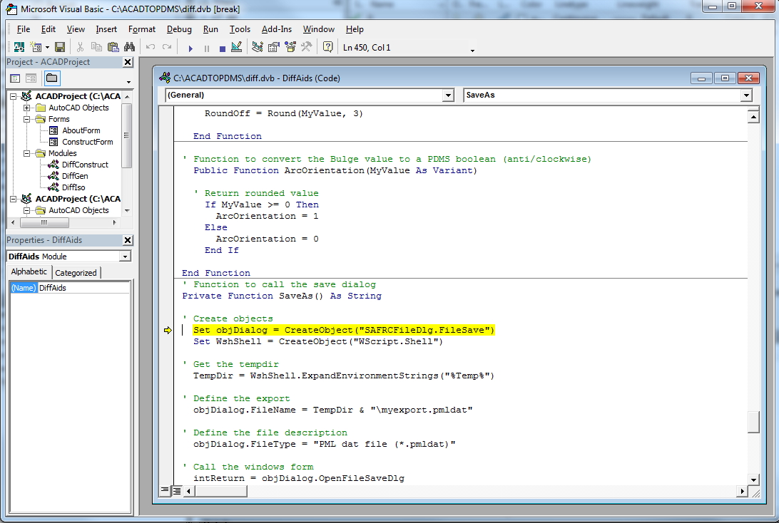

  • juan colmenares
  • jose leon
    jose leon over 12 years ago
    Hola a todos
    hemos usado esta herramienta en windows xp y funciona sin problema, pero en win7 da el error que mencionan los compañeros...
    He descargado la version mas reciente que esta publicada en este foro y da otro error, en el modulo de VBA "diff.dvb" algo con la rutina export, si el creador de la misma le pega un vistazo seguro que lo localiza
    Saludos
