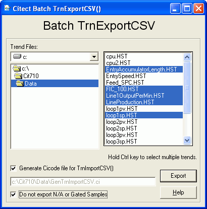

Batch TrnExportCSV
Anonymous
Anonymous
Export HST files to CSV, ready for TrnImportCSV()

Based on Eric Black's Trend Reader, this enables the user to export data from a batch of raw Trend files into CSV.
The format of the CSV files are such that they can be imported back into a Citect system via the TrnImportCSV() Cicode command.
