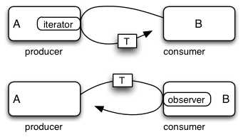

Reversing the Enumerable
We can start to understand FRP via the more familiar IEnumerable interface in C#. With an enumerable collection, we "pull" the next item out (via foreach) and then do something with that item . This is the basic idea of the Iterator pattern.
In FRP, we have the IObservable interface. Items are "pushed" from the observable collection, and we react to them. This is the basic idea of the Observer pattern.
The Iterator and Observer patterns are duals. We "pull" in the former, and "push" with the latter. In a sense, Iterator (= Enumerator) is to Enumerable as Observer is to Observable.
From http://www.cs.cornell.edu/courses/cs2112/2014fa/lectures/
In the former, the "pull" (Iterator.MoveNext) is a blocking call. The consumer must wait for the data source (or time out) before doing something with the item. In the latter, the receipt of the item is non-blocking. As soon as the item arrives, it is "pushed" to us.

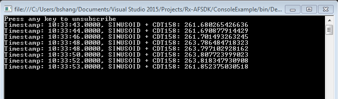

Here is the usage of the method above.
IObservable<AFDataPipeEvent> sumStream = sinusoidSnapshot.Add(cdt158Snapshot);
Now that we have the sumStream as an IObservable<AFDataPipeEvent>, we can subscribe to it as an observer. In Rx.NET, we can call the Subscribe method on the observable and pass in the implementation of the OnNext, OnError, and OnCompleted methods as delegates.*** Here, we will just implement the OnNext and have it write the timestamp and value to the console.
IDisposable subscription = sumStream.Subscribe(val =>
    Console.WriteLine("Timestamp: {0}, SINSUOID + CDT158: {1}", val.Timestamp.ToString("HH:mm:ss.ffff"), val.Value);
