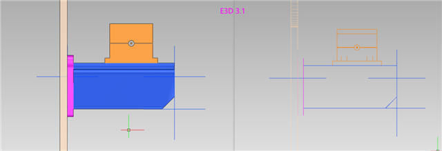

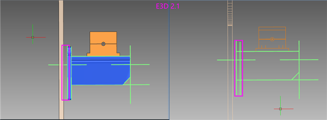

All the time, with the Supports-Tools- Pad-Creat pad created using E3D 2.1, the profiles are always embedded in the pad, resulting in the length of the profiles being one more thickness than the pad and unable to extend to the deck surface (either using stretch capture or input distance length). Automatically shrinks after stretching) This problem was later found not to exist in E3D 3.1

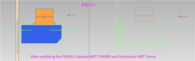

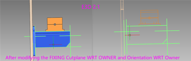

In order to solve this problem, we have been manually modifying the FIXING Cutplane WRT OWNER and Orientation WRT Owner properties to adjust to the normal state. However, this does not permanently fix the problem, as almost all changes to the bracket cause the FIXING Cutplane WRT OWNER and Orientation WRT Owner properties to change to their original state.
It was found by chance that FIXING Cutplane WRT OWNER and Orientation WRT Owner properties in E3D2.1 had problems. The cushion plate is embedded in the deck, and there is a gap between the cushion plate and the steel plate.
Coincidentally, in E3D 3.1, the pad created using the same way is correct without any modification
