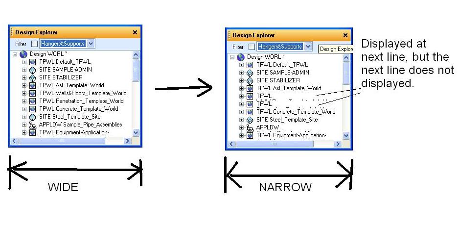

    By the way, talking about Design Exporer, why PDMS12 can not display folded(wraped) DB element name correctly?  This is confusing...
  • By the way, talking about Design Exporer, why PDMS12 can not display folded(wraped) DB element name correctly?  This is confusing...
    Can you post a screenshot of this problem?
  • Yes
    This problem(as above) is also version PDMS 12.0.sp2.1 and Marine 12.0.sp2.5
