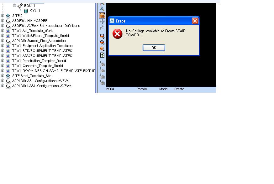

    hi dear go to admin and add aslconfig DB to ur MDB ;)

    Dear farid  thanks for your reply
    I have added it . you can see that asl config in explorer same in my snap shot also...
    waiting for you reply
  • Farid Malvandi
    Farid Malvandi over 11 years ago
    ok so u can add some db from master just one by one! ant test , I had this problem and when I added  asl config db it solved .

    I had also this problem. Sometimes ASL configuration from MASTER DB got messed up.
    So you need to re-configure APPLDW ASL-Configurations-AVEVA manually.
    If you want I can give you the setting that I manually re-configure via DBListing.
