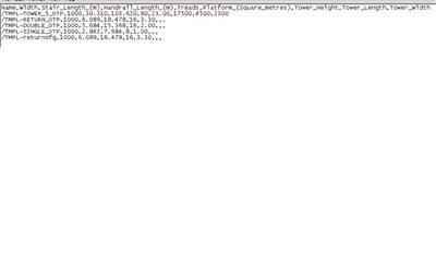

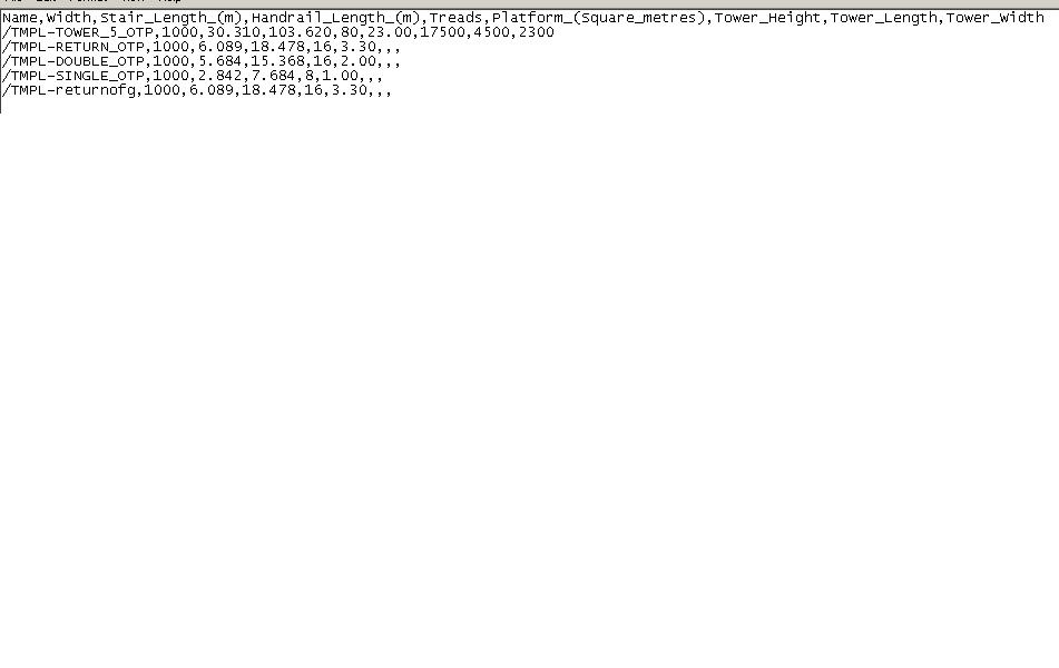

  • Could you post your .txt file on this forum? (a typical sample should be sufficient).
  • stair_name,platform_square_metres,handrail_metres
    /stair1,10,8
    /stair2,20,16
