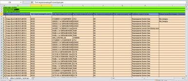

    Using of VBA greatly simplifies your life. But sometimes, with huge amount of data U will be waiting for long time...
    Now trying to simple use pipemtoreport.pmlfnc of user prashantuparkar,[COLOR=#3e3e3e] [/COLOR]coz waiting for 10 minutes to fill table with 2000 items.

    [/U]Working on function, to output collision list*

    Thanks, 'pipemtoreport.pmlfnc' is very nice!
    Unfortunately, TUBI component are displayed in quantity and not in pipe length (meter) in the quantity column.
    Any chance to modify this?
  • me_hungry
    me_hungry over 11 years ago
    Yes, its possible through PML.
    Some separation in the code between tubi and etc.
    I think somewhere between line 240 and 247..
