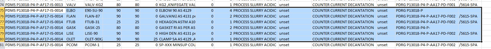

    are any limit character on pdms report
    [ATTACH=CONFIG]7785[/ATTACH]
    some text report was missing ,
