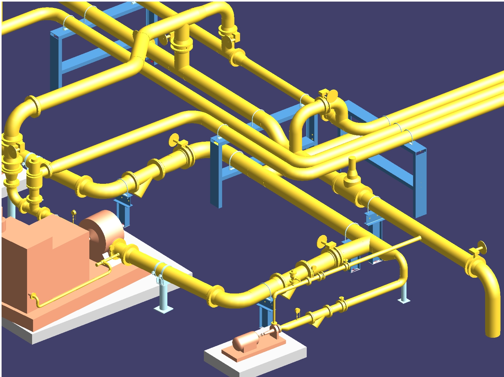

3000 mmscfd gas processing plant fire water design
  • Did you just model the pipework or did you have a had in its design?
    Should read... Did you just model the pipework or did you have a hand in its design?
  • what shall i say? it is nice...easy to be realized in pdms
  • From scratch gentlemen.......I could affix a small portion of the P & ID

  • i don't see pressure indicators in your model and also from the PID is missing pressure relief valves

    How did you model the drain? is it done by using floor and wall application (trace boundary) ?
    How do you plan to model the tank dike?
