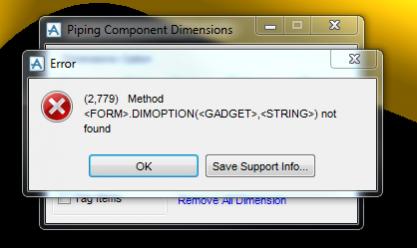

  • me_hungry
    me_hungry over 11 years ago
    My tool will calculate(I hope) the length  between two p-point. Sometimes U have very large formula(especially when U create rotation possibility).
    So , I have to calculate whether the p-point is beyond the limit(given in catalogue). In future it will output x y z lengths...
    When I creating categories, to test myself, I calculate the length between p0 and p3..as usual we have simple arguments ( SUM PARAM 4 PARAM 5)
    and what about trigonometric functions + despara + conditions. I think we need special tool, to eliminate human errors.
    I just posted dummy example how I see it :), developing it when have freetime..
