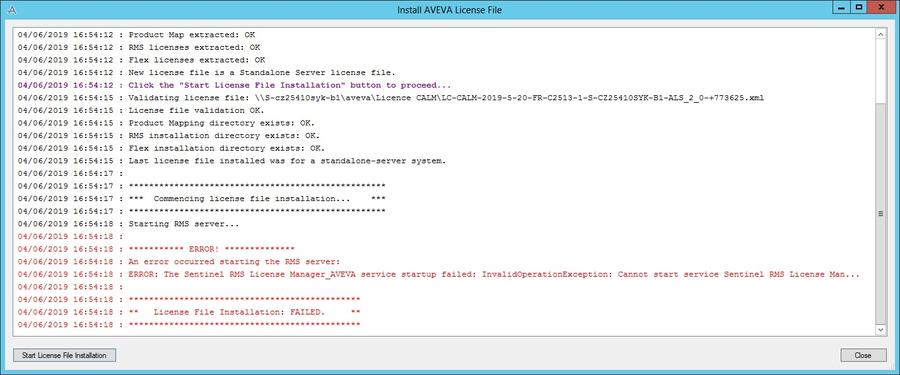

ALS (Aveva Licensing System) error RMS/FLEX server ?

    Try to restart your RMS Licence Service using service.msc>find this service by name>restart the service. Or if you installed RMS Licence service just now, restart your server and try again.
    IF (not working) THEN Re-install RMS licence Manager and again restart and try.
    Or better ask your local Aveva office to help you.

    thanks for your response.
    I have tried to restart the service RMS licence in the server but it doesn't want to restart :grumpy:
    maybe it's a problem with the server or other thing ....... I see with my server admin
    and I wait if the aveva support has an idea about this pb
    Regards
  • saomin
    saomin over 6 years ago
    hi i have a same problem pleas check this thing:
    1- check your firewall and you most allow connection between servers
    2- use Ip addres instead SERVER NAME
