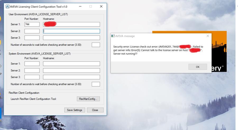

ALS (Aveva Licensing System) Licence Check Out Error

    Hey uisa,
    I think you need to tape your information at the system Environment and not user environment
    Also, did you checked if the FlexMan is configures ?

    You need to use port 4545 instead of 744

    I just checked on the Aveva website. ALS 2.0.0 is not interoperable with E3D 2.1.0 so I think you should at least use ALS 3.0.1 and the perfect is using the latest version ALS 4.1.0 !

    Hi Me_Hungry and YOU!
    Using port 4545 worked...thanks to the both of you for your suggestions.
