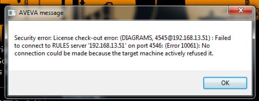

AVEVA Diagrams Getting an Error Message

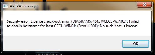

  • Venkata Rao Peta
    check host name properly, is your host name is right which is after 4545@ ??
    check the server if it on or off?

  • Venkata Rao Peta
    4546 why this port came into picture?
  • Szymon
    Szymon over 5 years ago
    In my opinion you have to change the ALS version
