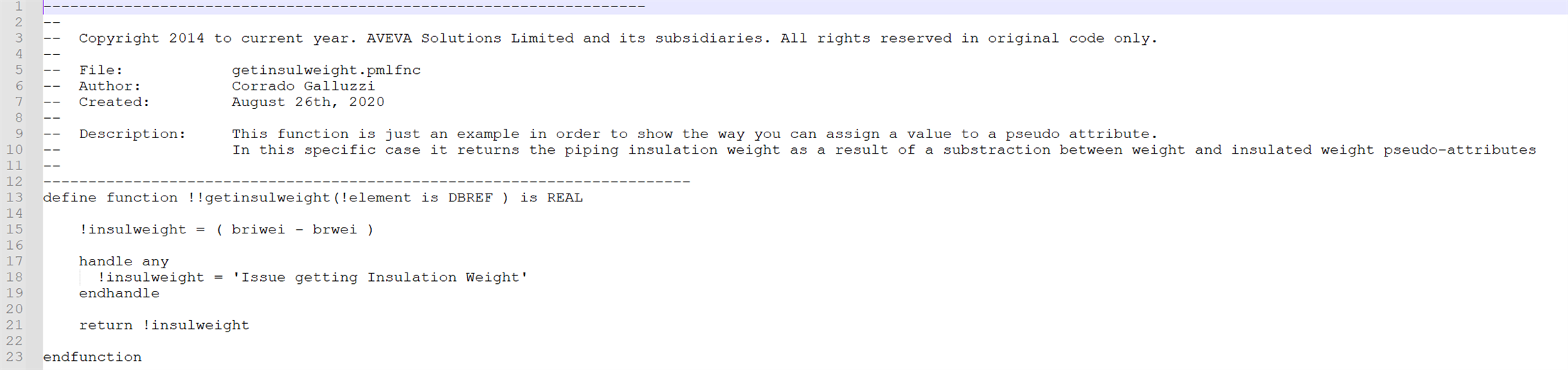

This is just a little and simple example of a Pseudo-attribute UDA that calculates the piping Insulation Weight.
Lexicon DB-Listing:
INPUT BEGIN
NEW UDA /INSULWEIGHT
ABLE 6
UTYP REAL
UUNI 'Mass'
TUNI 'kg'
ELEL ADD PIPE BRAN
UPSEUD true
UDPSFG 'getinsulweight'
UDNA 'INSULWEIGHT'
END
INPUT END UDA /INSULWEIGHT
INPUT FINISH
PML Function:

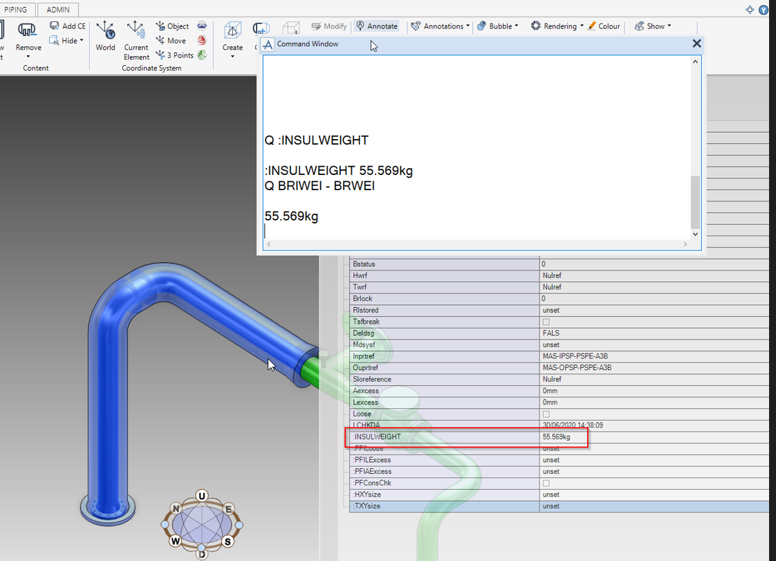

Result:
Thank you.
