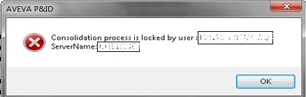

Hello,
It means that someone is using that drawing that you want to consolidate. It is better to open the drawing and close it properly. When you Open the file you will notice on the LOCKED BY column who are using that drawing.

Hello,
I have the same problem with AVEVAPID.
Do you have another solution?
Thank you

Hi bharatharun19,
This answer is correct, the problem is solved
Thanks for your help
