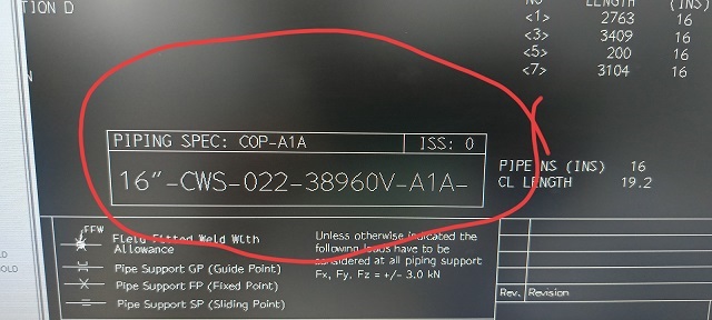

Dear Gurus pleas guide how to remove the encircled part from my isometric.
What codes or lines to be used in option file to remove them.
Thanks in advance for your kind support.
Try with this:
Atext 254 ''
TextPosition NAME X 0mm Y 0mm CharHeight 4mm
TextPosition PSPE X 0mm Y 0mm CharHeight 4mm
Thanks Mr. Corrado Galluzzi.
