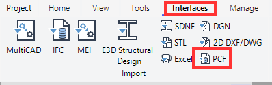

In E3D 4 Series you can import PCF files:
When you say "C2 Analysis" you mean Caesar II i guess, don't you?
In that case you can use the specific two ways interface included in both E3D 4 and 3 Series:
Thank you for confirmation I cant see this in 3.1.7.1 that might be available in 3.1.8.1 onwards
FYI In 3.1.8 it is not available
Hi Corrodo...It E3D 4.0 out yet? I just searched on the product hub but couldn't find it. Or is it part of UE 3.0.0?
E3D4.2 is part of Unified Engineering 3.0, which has been released in december 2024. Not possible to use ALS.
