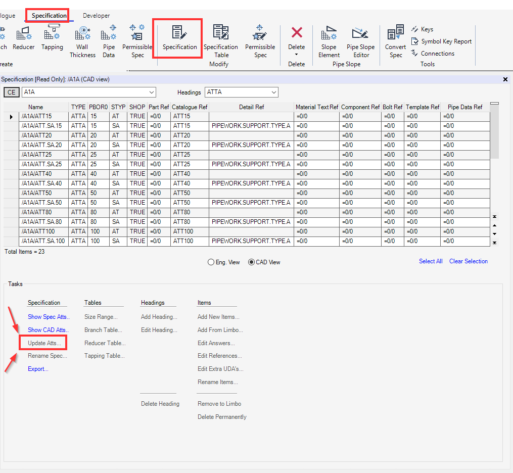

Hello guru,
anyone knows below error, especially while using paragon module.
There are mismatched reference attributes between some specification components and the associated gparts.
Use 'update atts..' to update the specification components.
i try to use command, update atts.. but i don't know the complete command. meanwhile the command don't work if not complete.
any suggestion?
