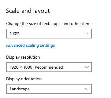

Hello Everybody!
I m having a viewing problem with E3D i changed multiple times the resolution on windows but still the problem occurs. any ideas???
Thank you all!
Hello Everybody!
Thank you all!
Go thru this thread for solution
Thank you! I tried that but did not work I think it has something to do with the monitor LG 4K ...
After applying resolution settings, delete contents in C:\Users\username\AppData\Local\Aveva\AVEVA E3D Design\3.1 folder before entering E3D.
try different resolutions not only 100 %
