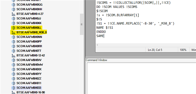

Thanks for reply Deva, but I want to change scom BLRFARRAY attribute for scom both btse are already available.
!SCOMS = !!COLLECTALLFOR(|SCOM|,||,!!CE)
DO !SCOM VALUES !SCOMS
$!SCOM
!A = BLRFARRAY
DO !I FROM 1 TO !A.SIZE()
$!A[$!I]
!S1 = !A.NAME.REPLACE('-8-', '-M8-')
NAME $!S1
ENDDO
ENDDO

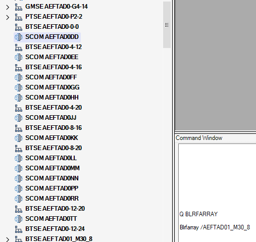

I wanted to change boltset of scom with different something like this .
$!SCOM
!A = BLRFARRAY
$!A[$!I]
!S1 = !A.BLRFARRAY[1].REPLACE('/AEFTAD01-4-14', '/AEFTAD01_M30_8')
BLRFARRAY $!S1
ENDDO
ENDDO
but showing error (2,759) Object does not have a member
BLRFARRAY
