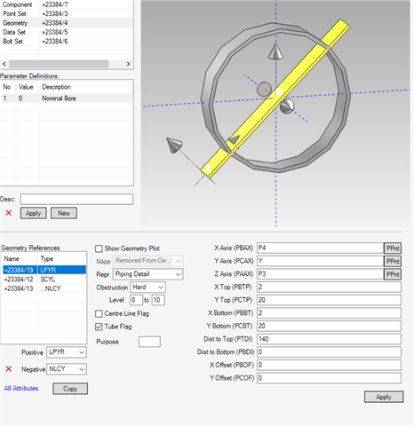

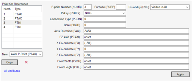

I want to create a box from P3 to P4
Hello Bogdan,
You can use the LPYR element along with 2 PTMI points, see my screenshots below:
