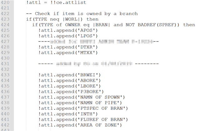

To get pseudos on the dump att file you need to modify cdxattdump.pmlfrm file
For example:
