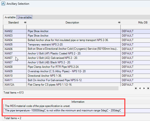

Hello,
How can I make this ancillary available?
ACP is included as foreign in my project.
Thanks.

The reason why the ancillary is not available is written at the bottom of the form:
Before the Support Application can be used, the E3D administrator should go through a list of tasks.
Please check with she/him.
If you are the administrator, I would suggest to attend a training course if you have not already done it.
HTH
