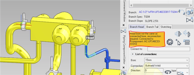

If i try to connect a Branch to a PCOM ( Skey UNIV ) PPoint 4 or higher.  I get following error in the "Pipe Editor Modify Pipe". The Connection itself is correct (p4bore, p4con etc), and the Isometric is fine. But the Check says that the Bore is wrong.
It looks like the check ignores the possibility of more than 3 PPoints with different Bore Sizes then PP3.
