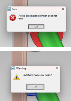

Hello to all,
Im getting this error when I try to place 2 ancillaries in framework
Can anyone help ?
Thanks in Advance
Hello to all,
Can anyone help ?
Thanks in Advance
Hello, I am not exactly sure but I see the following possibilities:
1. The MDB selected when you opened AVEVA E3D at this time might not be the appropriate MDB for support modeling in your setup.
Please try to check the MDB selected in the AVEVA E3D launcher before starting up the application.
2. Or the MDB that you used on this time is not properly configured in AVEVA Administration (the database containing /av-exists2 is not loaded).
Please try opening an AVEVA-supplied standard project (like APS) and check where /av-exists2 is in the database.
