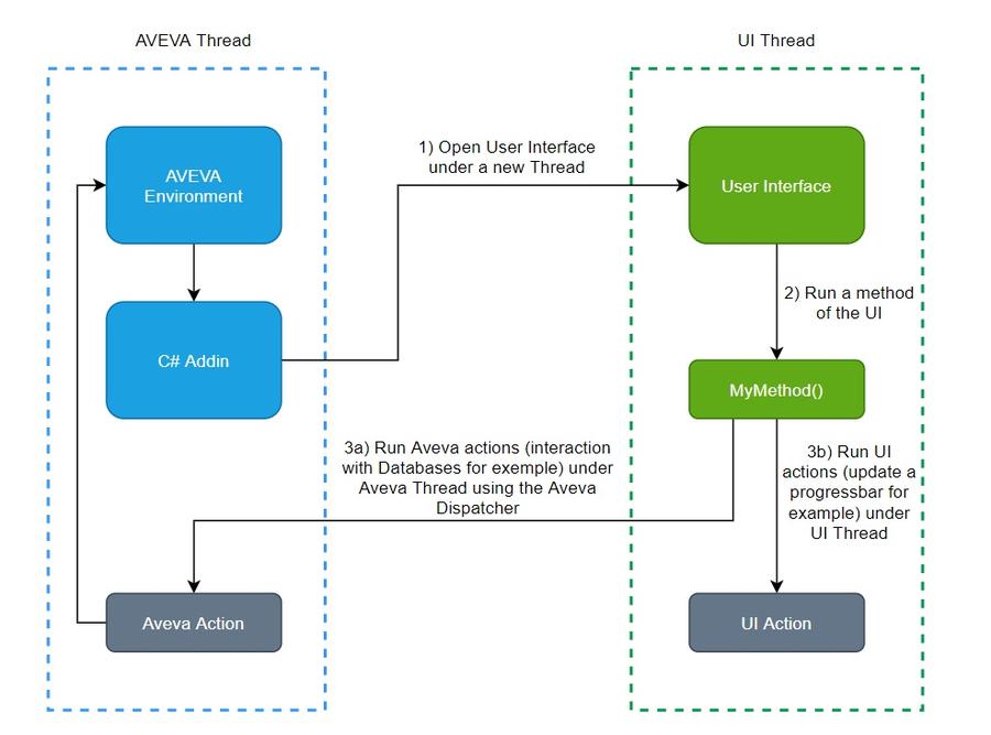

    More generally I also use Dispatchers:
    https://docs.microsoft.com/fr-fr/dotnet/api/system.windows.threading.dispatcher?view=netcore-3.1
    By retrieving, when starting my application, the dispatcher linked to Aveva's thread:
    Dispatcher avevaDispatcher = Dispatcher.CurrentDispatcher;
    And run the functions from another threads through this dispatcher:
    avevaDispatcher.BeginInvoke(new Action(() => MyMethod()));
    With this solution, MyMethod(), that interacts with Aveva DBs for example, will be executed in the Aveva thread, from a parallel thread.
