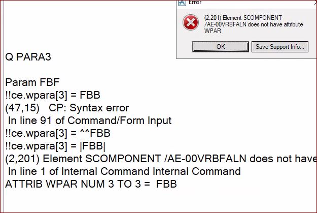

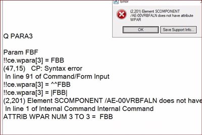

  • Sri
    Sri over 4 years ago
    i too have the problem with feeding the end connection for a scom
    !!ce.para[1] = 50 will give success
    !!ce.para[2] = 60.33 will give success
    !!ce.para[3] = FBB will give not success
    how to insert ?FBB?
  • Shrivallabha Sharad Redij
    Shrivallabha Sharad Redij over 4 years ago
    Instead of
    !!ce.para[3]
    You have to use
    !!ce.wpara[3]
    as demonstrated by @stpandi
  • Sri
  • THANGA PANDI
    THANGA PANDI over 4 years ago
    $!!CE
    PARAM N3 FBB will work!!
    -stp
  • Sri
    Thank you @stpandi
    its worked well like desparam  in Design.
    would like to know more in details, what make difference from  inserting this number(!!ce.para[1] = 50) to string(!!ce.para[30 = FBB]) in this context?
