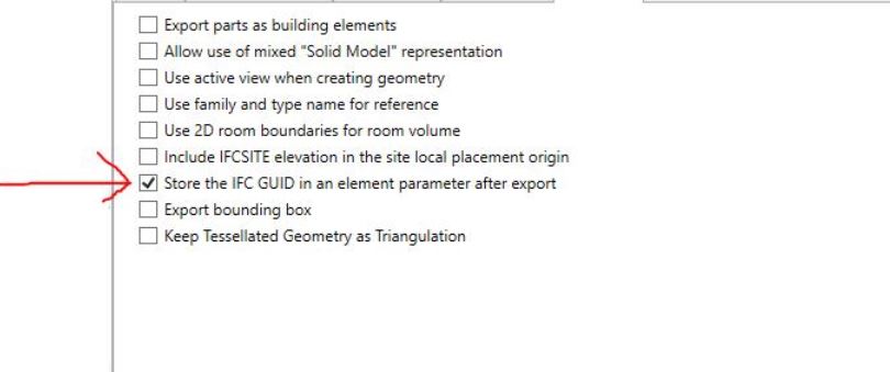

Thank you so much Corrado and sorry for the delay in the feedback.
What I seem to understand is that when we export the ifc of some systems we still have the replication of the parameters with different GUIDs; this despite the fact that you do savework between one extraction and the other because it is not an extraction of the entire model.
