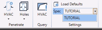

I created a new HVAC spec and set its PURP to HVAC.
But it does not show in the SPEC combobox in the ribbon, only the TUTORIAL spec is listed.
And when I try to create a new HVAC element, it's using the default /AVEVAHVACSPEC spec. Which can be confirmed by Q PSPEC on the newly created element.

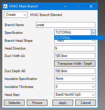

Also, by trying to create a new Main Branch Element, the following dialog pops up and only TUTORIAL is shown in the combobox of available specs. Not even the default Aveva spec is shown there.
Is there any additional step to make the new HVAC spec visible in Design?
I can access it by it's name using Command Window, so I'm sure it's available in the MDB.
