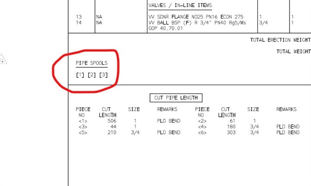

Yes I want to export the spoolist of each pipe in a report (txt or csv file).
After extracting isometric, I see those numbers appear which I don't need to define "pipe fabrication" tool or through Spooler Module. I also tried to get those value by export material list in option files and built small script just get the pipe line and pipe spool value in material list . But It's not a good way to do. I don't know another better way to do it

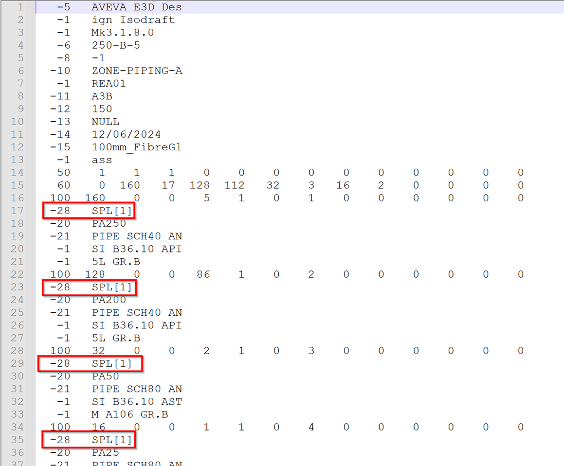

Maybe you can use your script with the Material Control File (MATC) that is formatted and search for record number 28
