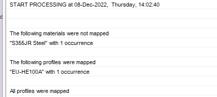

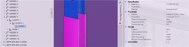

I'm trying to create an SDNF of Steel with a Fittings of Fireproofing around, but it's shows that the spref and matref is not included on the SDNF log file.

Do you mean you are trying to export a GENSEC with a fitting using SDNF file, aren't you?
SDNF format is quite "poor" so fittings are not exported
I see... Thanks for the info
