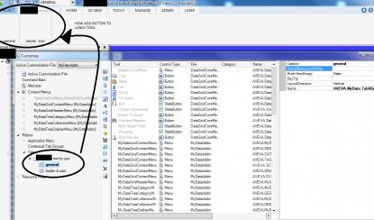

    There is a new pmlcmd folder within the pmllib. You will have to make a pmlcmd then add it to the the loadusercommands.pmlfnc within the common functions folder.
    Steps:
    1. Create pmlcmd file
    2. PML REHASH
    3. PML LOAD COMMAND !!commandname
    4. !!commandname.register
    5. create the button within the ribbon
