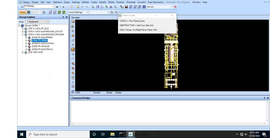

    Dear Sir
    please explain how to use this macro......
    I have changed M:\ to C:\.....and in my case a window is popping us titles as ..
    What To Add
    CHECK= Your Piping Zone
    OBSTRUCTION= Add Your Site And
    Other Things You Might Have Clash With
    I don't know how to proceed further.....
    Thanks in advance..

  • Majid Iranmahbob
    Majid Iranmahbob over 4 years ago
    Hello
    Please share a screen shot
  • Harender Singh
    Harender Singh over 4 years ago
  • Majid Iranmahbob
    [QUOTE=harender20;117721]Dear sir
    please find the attached snapshot...
    macro is not complete please download it again and just change the M:\ to your desired location

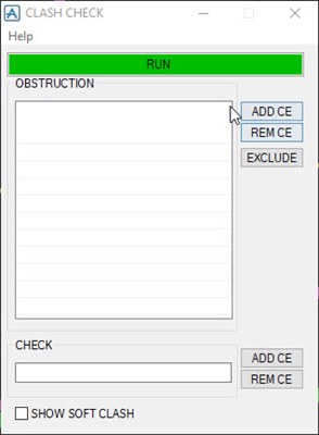

  • Majid Iranmahbob
  • Harender Singh
    Still the same problem i am facing...
    Is it possible if you can upload your macro file here in thread now....the one you are using...

  • vishal ashokan
    vishal ashokan over 4 years ago
    for me this error is coming
    2,779)   Method .CE1() not found
    In line 1 of Command/Form Callback Command
    !THIS.CE1()
    !THIS.CE1()
  • vishal ashokan
    Not working in e3d can u plz help
