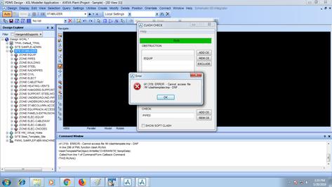

    Hello all
    i've been getting a lot of help from this forum
    i want to do my share and give something back
    i found the reporting part of macro in this forum and modified it a bit
    in order to work properly in line 288 change the patch to your local drive ( dont change the clashtemplate.temp just the M:\ )
    hope it helps.
    https://www.dropbox.com/s/ovtkdyvm4xaw2rn/CLASH.pmlfrm?dl=0

  • mohmad saif mujawar
    mohmad saif mujawar over 7 years ago
  • rboopathi
    rboopathi over 5 years ago
    same error to me also / what to do? anyone
  • rboopathi
    Its working after changing drive from m\ to c\
  • Majid Iranmahbob
    Majid Iranmahbob over 5 years ago
    Yes i mentioned in the first post that you need to change the m:\
