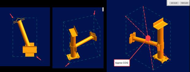

Can you please tell me how to construct a line as shown in above attachment around the volume of CE
In some of equipment small element (box, cyli, genpri) is modelled somewhere else(not connected to equipment), for such case this Line construction will help to see the volume covered then i will delete the unwanted small element (box, cyli, genpri) which is modelled somewhere else(not connected to equipment), if i check again

as you suggested i tried it some of the drawlist members have branch, frmw, for those items position attributes not available so i cannot collect the correct limit volumes. can you please rewrite my macro
