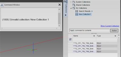

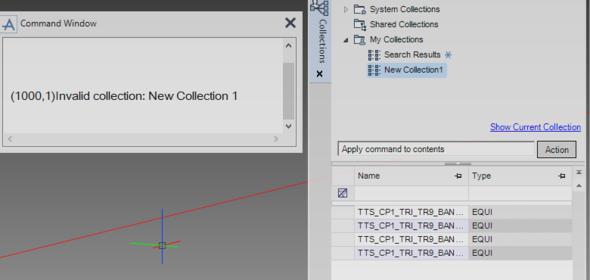

  • Hello dear Citron !
    In your screenshots you seem to use "My Collection 1" while the name of your collection is "New Collection1".
