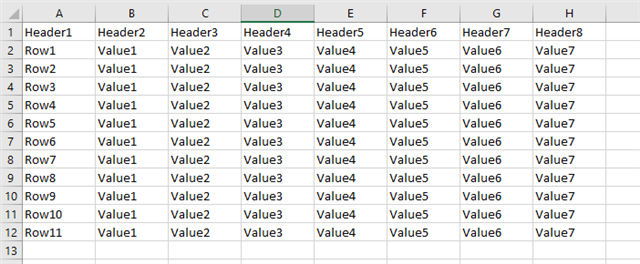

I wish count the row and column from The function
Sri , Ok, well then try this :

q var !grid.GETCELL(2,2)
-- show your rows
q var !grid.GETROWS()
-- show your columns
q var !grid.GETCOLUMNS()

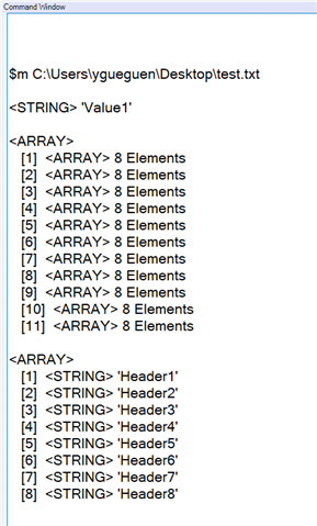

Result :
All the methods can be shows up by using .methods()
Like :
q var !grid.methods()
or
q var !nds.methods()

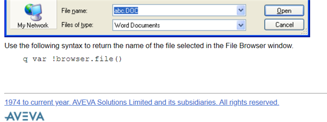

Based on te code above, user will be prompted to pick an excel file. May I know how to find out the file name that was pickup from the file folder?
LT
Hello Luke,
I think the code to get the file name is the following
q var !browser.file()
https://help.aveva.com/AVEVA_Everything3D/1.1/NCUG/wwhelp/wwhimpl/common/html/wwhelp.htm#href=NCUG8.html&single=true
