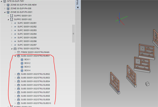

Hello my friends,
I would like to call all plate in below subs hierarchy for MTO.
what i need to write for suppcodetype as per below red highlight?
if !suppcodestype eq '/SUBS*' then
var !attasize p1bore for $!result[$!attaloop]
!attasizestring = !attasize.string()
!attasizetrim = substring('$!attasizestring',-3)
$!anciname
!ancidbref = !anciname.dbref()
!detail = array()
!attasizereal = !attasizetrim.real()
!suppdesc = PROP CDES OF $!anciname
!plate1 = 'STEEL PLATE'
!profile1 = 'PL$!ancidbref.DESP[7] x $!ancidbref.DESP[5] x $!ancidbref.DESP'
!quantityplate1 = 2
!recData.append('~$!anciname~$!suppdesc~~~$!attasizetrim In~$!suppcode~$!dtxr~$!pipename')
!recData.append('~~$!plate1~$!profile1~$!quantityplate1')
endif
