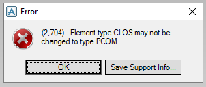

  • If you just moved it from one heading to another, then reference from design didn't changed. And you don't need to delete it in design, just tap standing on clos "changetype to pcom"

  • CHANGETYPE TO PCOM returns with this error:
