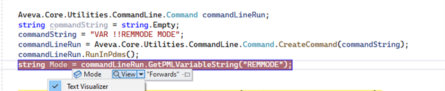

Have you tried store result in pml variable as below example
Aveva.Core.Utilities.CommandLine.Command commandLineRun;
string commandString = string.Empty;
commandString = "VAR !!REMMODE MODE";
commandLineRun = Aveva.Core.Utilities.CommandLine.Command.CreateCommand(commandString);
commandLineRun.RunInPdms();
string Mode = commandLineRun.GetPMLVariableString("REMMODE");
